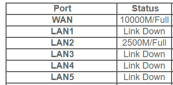

Below is the status of the WAN and LAN port.

      The ONT is irrelevant as wireless speeds are fine via the Orbi 971. It is some form of Adtran. It connects at 10000 as per the the screenshot.
