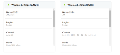

2. Current set-up was working fine for 2.5 years, Wifi 5ghz seems to be online in the admin portal but even though i can connect to it the connection is dropped within 30mins of connecting. Previously it was either not visible at all or when visible devices could not connect. I've performed one more hard reset today which allows devices to connect but as i mentioned connection is lost after approx. 30 mins

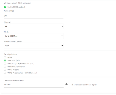

Here is the 5ghz set up:

Go in and set your "up to ****" speed from up to 4800mbps to 2400mbps. You're using dfs channels. Not sure how frequently they're used in EU (since it looks like your region) but if a new weather/radar is broadcasting in your area, it could be causing issues. You'll also want to check whats supplying internet. Double nats can cause all kinds of random issues. Its usually not a problem but it could be causing your "connected, no internet' issue.
- plemansSep 23, 2024Guru - Experienced User
and after you change it to up to 2400mbps, make sure to select a non-dfs channel for your region.
- Markie610Sep 23, 2024Tutor
Hey, changed it to 2400mbps, selected channel 44 is non-dfs channel. Will report back see if it helps!
