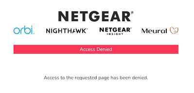

Can't login to RAX43v2 to change settings
Any time I try to login to my router, a RAX43v2, I get prompted for a username and password as expected. However, as soon as I enter my username and password I get redirected to this stupid, unhelpful, indescript error page.
The URL it keeps directing me to is: https://accounts-qa.netgear.com/error?redirectUrl=http:%2F%2F192.168.1.1%2Fgenie_redirect_SSO.htm&serial_num=NOTMYSERIALNUMBER and I am very confused about what is going on with it. I was trying to get my new TV on the wifi and no matter what I tried I was unable to get it to connect to the main SSID. It was only connecting on the Guest SSID.
I have tried on 2 different computers, on my phone, it makes no difference. I've even tried the www.routerlogin.com page.
As it stands I am unable to get in to manage my router. What gives? Why does my local admin login have to reach out to the internet for verification? Just let me in to the local administration interface!

- When I go to the local router ip address of 192.168.1.1 and login with my credentials it does the same thing. Redirects to this qa page and says authentication failed. Sorry I didn't make that clear.
No matter what url I try to login to for my router, it kicks to this remote server which is obviously not working.

The "solution" was a factory reset.
My last backup was from October. Guess I'll be doing weekly backups of my config from now on. Thanks Netgear.
