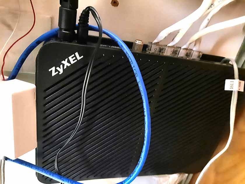

      We have a Nighthawk Model RAX70 and the firmware is listed as V1.0.12.114 which is posted on the password reset screen.  We're looking for working login credentials, documentation, and advice before we make any changes.
      We really don't know much about the modem or even which wired box it could be so here are snapshots of the existing equipment:
      Hawaiian Telephone handles the connections and say the all looks good with the modem.

        If this "modem" is the ZyXel thing in the picture, I can't see any indication of a model number. However, the confusing (to me) picture of the thing suggests that it may have a set of LAN ports on the top. If so, there is a high probability that it is a modem router. Add that to the RAX70 and you may have two competing routers on your network.
        Two routers on a network can cause headaches. For example, you can end up with local address problems. Among other things, the other router can misdirect addresses that the Netgear router usually handles, such as routerlogin.net or the usual IP address for a router, 192.168.1.1.
        This explains some of the other drawbacks.
        What is Double NAT? | Answer | NETGEAR Support
        It may be possible to put the modem/router into modem only (bridge) mode and then to use the second device as the router. Sometimes it is easier to put the second router into AP mode. But that has its own drawbacks:
        Disabled Features on the Router when set to AP Mode | Answer | NETGEAR Support
