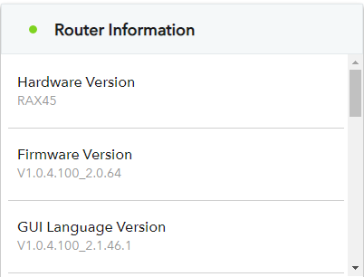

      A: V1.0.4.100_2.0.64 (Confirmed most up to date my GearHead support)
