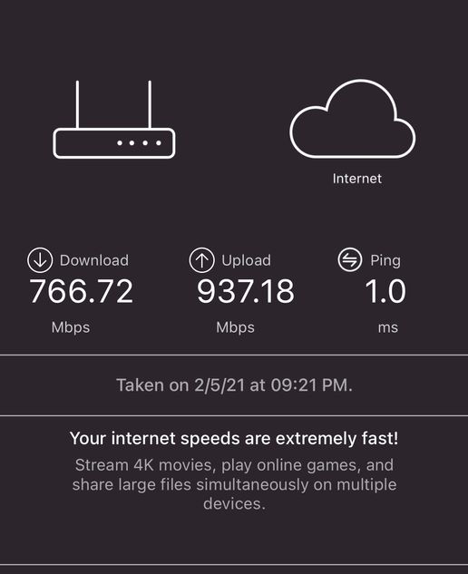

I have Google Fiber, which when I run a speedtest through the Nighthawk app gives results typically like the below (within 5-10% or so)

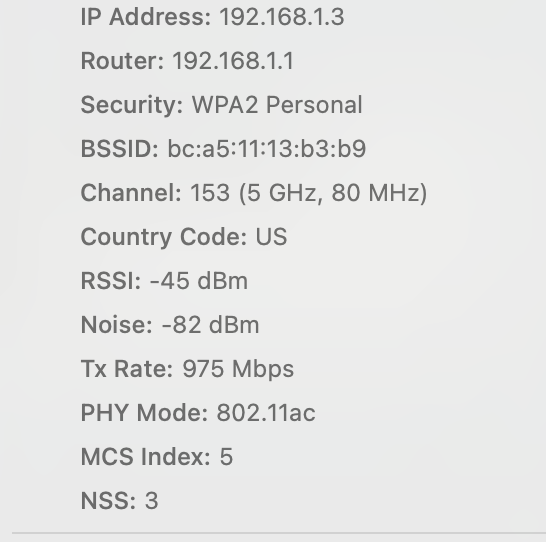

And I know my internet connection from my laptop to the router is strong... I'm in a small apartment with few obstructions, and see these types of details for my network below

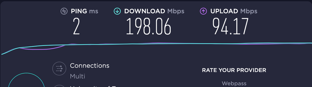

But consistently, when running speedtest with ookla or similar, the bandwidth is less than half of this (with no other devices on the network).  See below
I understand bandwidth can fluctuate-- and im not crying about slow speeds, it's still plenty fast for most needs.  But I've updated the firmware, removed obstructions, and done all i can, and even when I plug directly into the router I can't get speeds above a few hundred Mbps when the speedtest through the Nighthawk app consistently gets 7-800 Mbps.  Any ideas for why this is or any tips here?

      1) when running the test directly from the router (which I assume is *most* like plugging right into the ont line for Google Fiber), i was getting 750 down, 920 up
      2) my mac shows that i'm connecting consistently at 900+ mbps to the router itself (using the option-click on wifi on the mac)
      3) running a speedtest from my device, i'm seeing speeds between 2 and 300 mbps, the one i posted was even less than that.

        2) my mac shows that i'm connecting consistently at 900+ mbps to the router itself (using the option-click on wifi on the mac)----Your link speed over wifi you mean? What wireless chip is in the mac?
