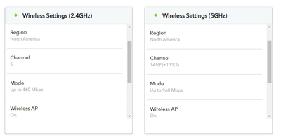

      Hello Razor512,
      The answer to your question about the wifi channel and region are noted below.
      Thanks,
      CJ-USA
      • Razor512's avatar
        Razor512
        Prodigy
        That helps to rule out DFS issues since you are still experiencing issues while the router is forced to not use any DFS channels, as well as sticking with a single set of 2.4GHz channels.
        In that case, you can return those settings to their normal ones. (2.4GHz set to auto) and 5GHz set to the highest speed option available and a channel such as channel 44.
