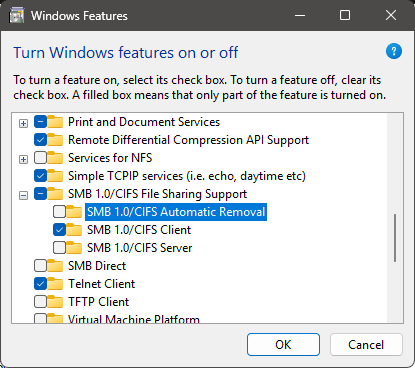

Possible MS did someting in a update. MS has deemed SMB a security risk, especially v1.
Be sure you disable this SMB Auto Removal as well:
Also there are some odd issues with MS Windows 11 24H2 and FDResPub services in windows that maybe at play as well: https://learn.microsoft.com/en-us/answers/questions/4375194/fdrespub-service-won-t-stay-running-preventing-net
This is an MS issue.
