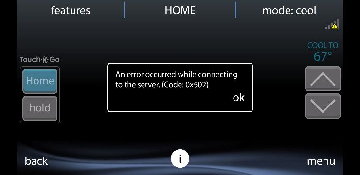

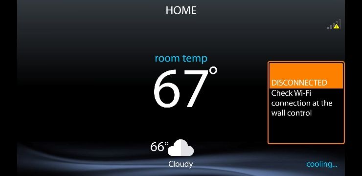

I switch to a Rax40 then to a rax80 a few days later. Ever since cannot connect to my Carrier Infinity Thermostat. I see another post with the same issue using or but No solutions

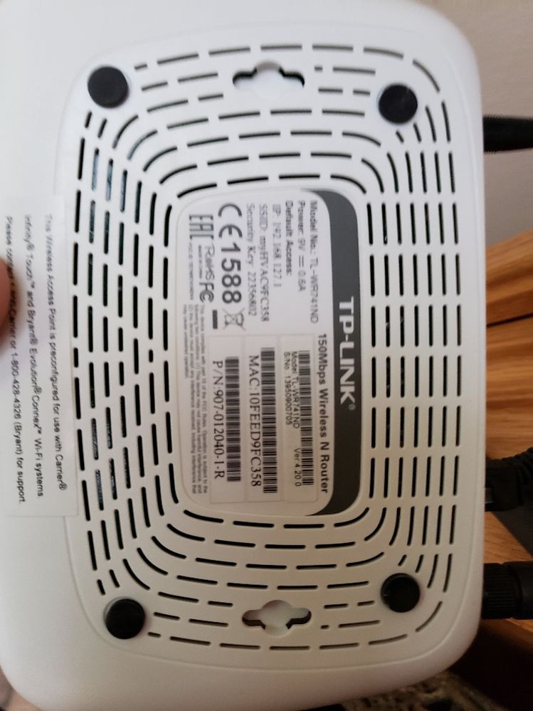

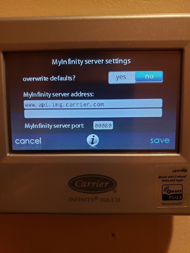

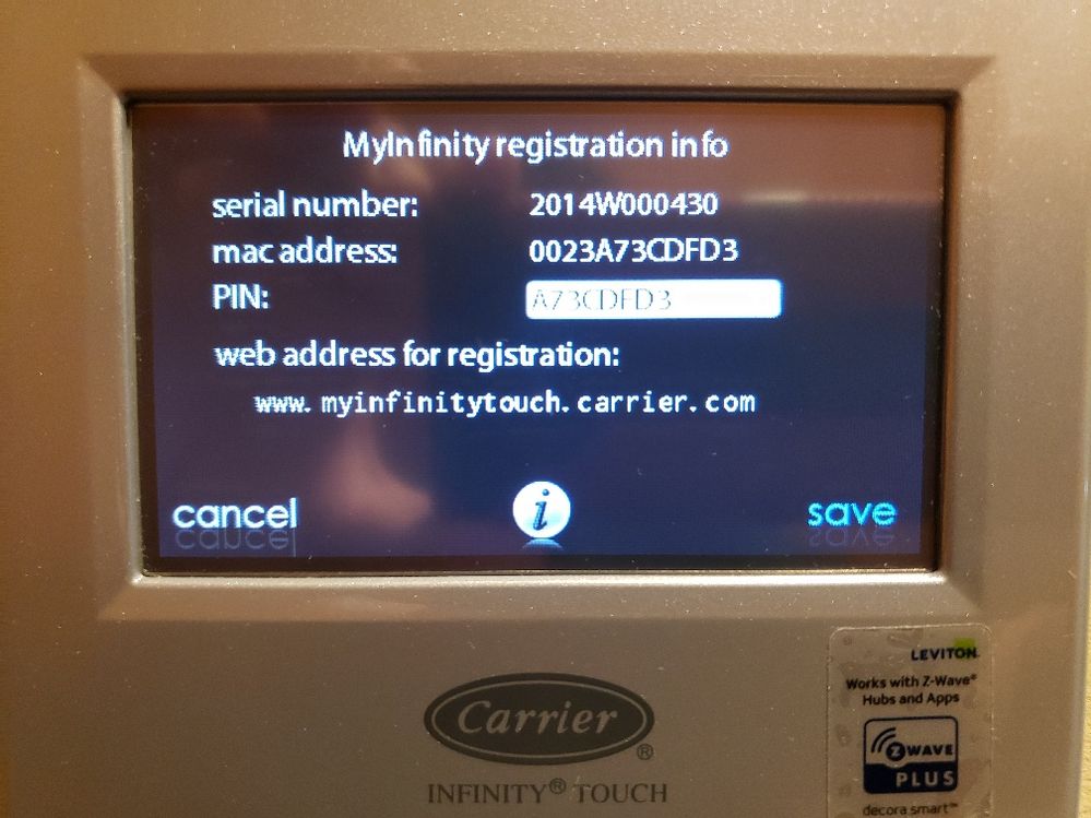

The attached photo(s) is the TP-LINK wifi device that is hardwired to the Router connects the Carrier HVAC Thermostat. Screenshots with info & error codes are from the Android app use for remote control. Actual photos of the wall unit have the brown wall as a border showing the info the thermostat shows. From all my troubleshooting I am connected to my homes network, however, the unit cannot connect to the Infinity server with using a Rax 40 or the Rax 80 I Now!
This was never an issue with my ac1900 TP-LINK router or any other Router I have used. I trust an expert can respond with answers & photo instructions so I'm not to return this Router also.
