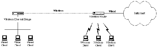

    A WiFi wireless bridge would be for connecting two Ethernet segments over a WiFi wireless link.

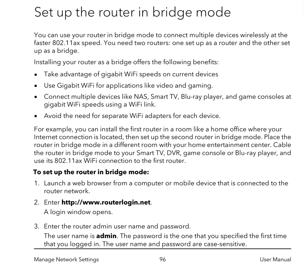

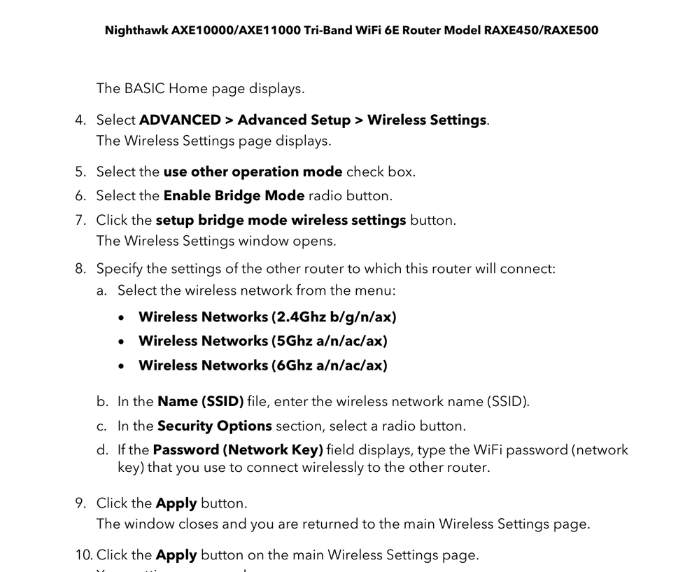

      It does - at least it's documented in the fine RAXE500/RAXE450_RAXE500_UM p.96 ff. Set up the router in bridge mode
      Convinced the OP CodenameFalcon knows about this section of the UM.
