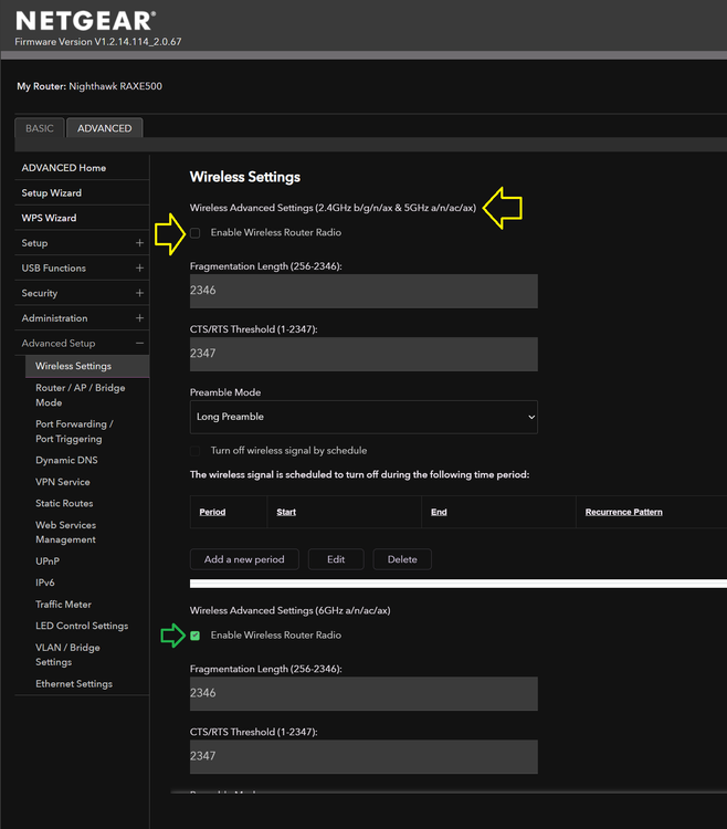

    I attempted to disable the 2.4 and 5Ghz radios on the router, however the 5Ghz LED is still ON on the router and RAXE500 is still being seen by 5Ghz devices:
    I then disabled Smart Connect on the Basic Wireless settings page then unchecked the Enable Wireless Rotuer Radio under the 5Ghz SSID section and selected Apply. The RAXE500 SSID name finally disappeared from the 5Ghz devices view.
    Setting the RAXE back to bridge mode on 6Ghz. The router rebooted, this time the internet LED turned RED then finally WHITE, Power LED shut OFF, the 6Ghz LED didn't turn ON. After waiting a few minutes, the 5Ghz LEd turned on and I checked my 5Ghz devices and the RAXE500 SSID name was re-appearing again. Oy vay. So PC failed to get connected and I had to set a static IP address on the PC to get to the RAXE web page and get back to router mode.
    So I then disabled all check boxes under Basic Wireless to disable 2.4 and 5Ghz radios, leaving 6Ghz enabled. Checked advanced wireless setting as well and left only 6Ghz enabled. Set back to bridge mode. Router rebooted. This time, power LED turned WHITE, Internet turned OFF. All 3 LEDs for each frequency turned ON. PC got internet services. NO additional SSIDs coming from the RAXE.
