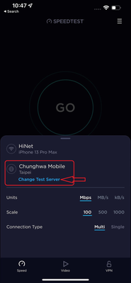

Hi Jbarrick17,
Which Speedtest server were you choose? Sometimes use different speedtest server would gain different results.
You can try the nearest one.
