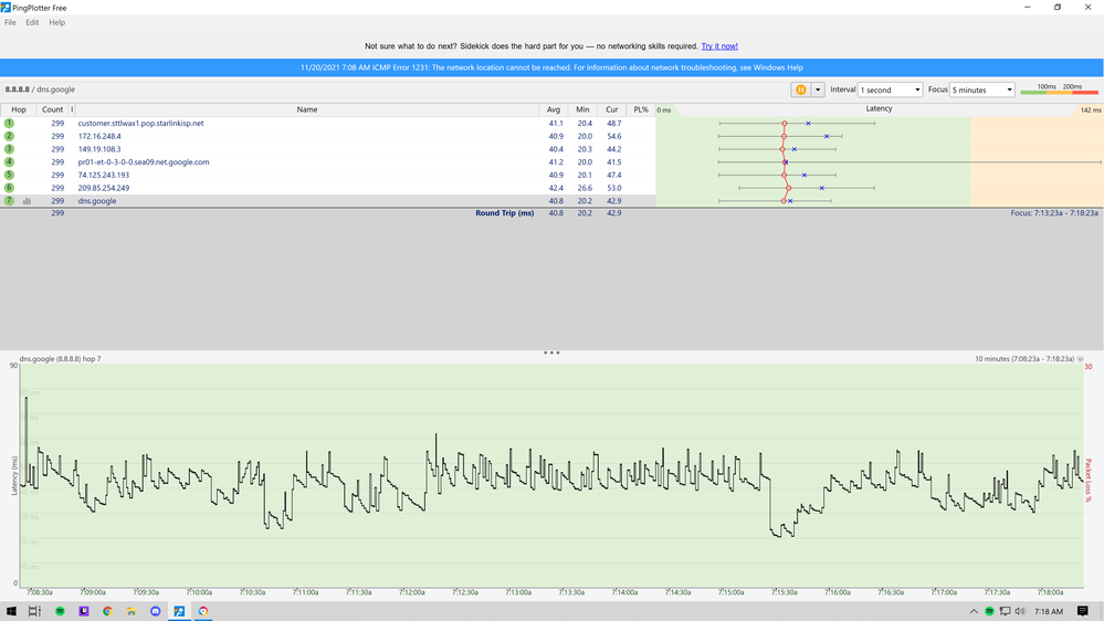

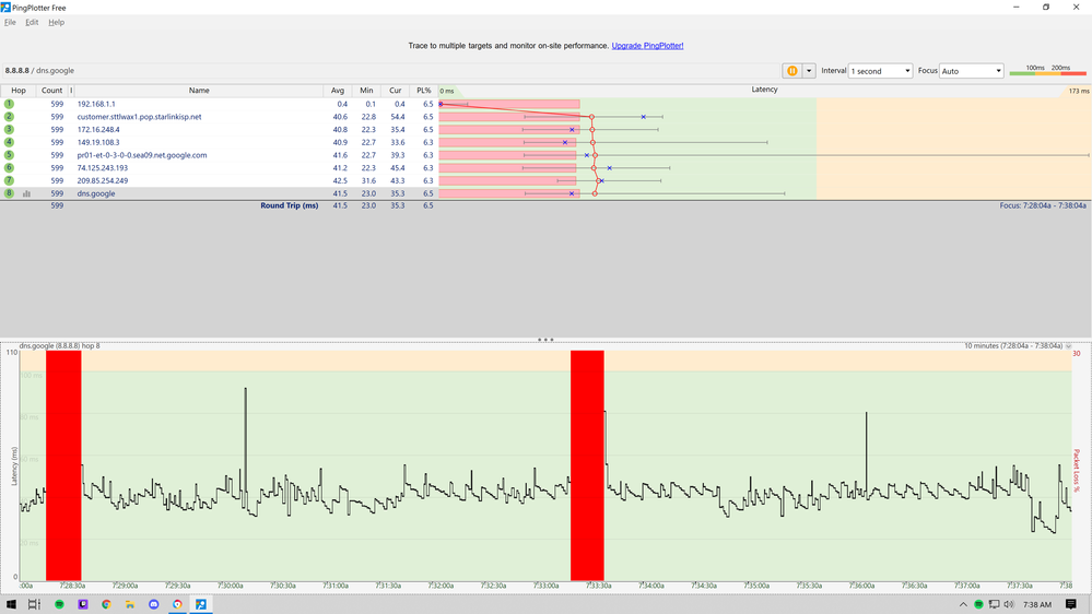

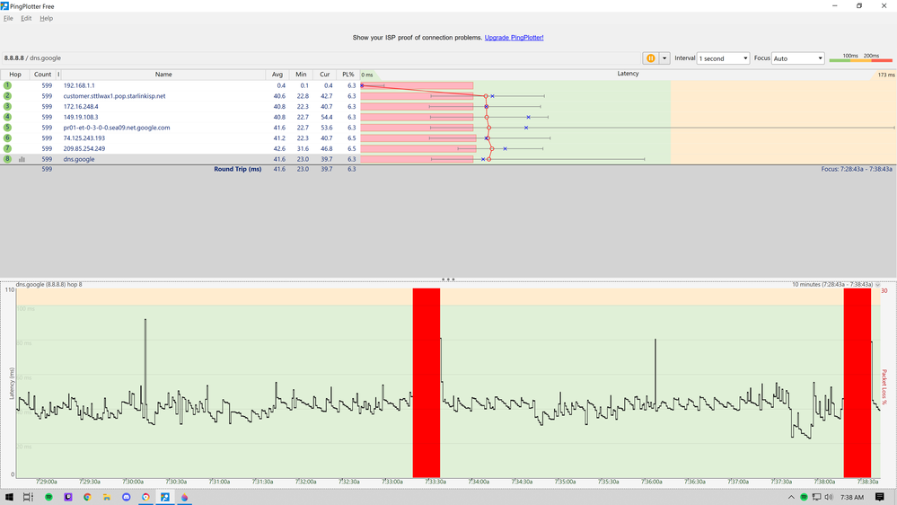

Router goes to 100% packet loss exactly every 5 minutes.
Issue started a week ago almost exactly. Drops internet for about 15 seconds every 5 minutes. I know it is a router issue as I have connected directly to my modem, used a different modem and even a switch. Issue only happens while connected to this router either WiFi or direct. I do not mess with any of the router settings except SSID. Issue came out of nowhere. Anyone have any ideas? Tried to revert to an older software with no luck. Attached are pictures of said issue.Direct to Starlink ModemNetgear RouterNetgear Router

      Starlinks modem. Tried older software still does it. Has to do with something with the router. It literally happens every 5 minutes for 15 seconds, as the pictures show. So it is 100% router related. Hoping someone else has come across the issue.

  • RAX50 Nighthawk, Firmware V1.0.4.100
    This just started happening to me too.  I've had this router a few months.  But the 15 second dropout every five minutes just started a day or two ago.  I also use it on Starlink.  Only difference is that the Starlink proivder location change from Chicago to Kansas about the same time period.
    I booted the Nighthawk and that changed the timing of the five minute dropouts, so it seems to be router related.
