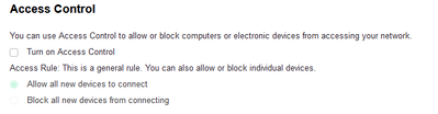

Where are you looking on the router? Maybe it has moved in new firmware. Here it is buried in Attached Devices:
Then:

The Access controls page was under the Security -> Access Controls (Advanced Tab). I've also looked on the Attached Devices page, but it does not exist there.
On the Orbi App, it is no were to be found. The Access Controls option was never there on the App.
