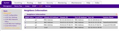

Hola! Tengo un Netgear GS724T-v4, este dispositivo cuenta con tabla de IP de los dispositivos que i?
Me gustaria saber si el Netgear GS724T-V4 tiene la opcion de mostrar las IP de los equipos que tiene conectado, lei en el manual y me indica que en las siguientes ventanas:
Seleccionar Sistema > LLDP > Información de vecinos de LLDP-MED .
Pero alli solo identifico las mac, hay alguna otra forma o este Switch no maneja tabla de IP?
Gracias y saludos.

      El modelo GS724Tv4 es un switch de capa 2, así que no maneja direcciones IP, sólo MAC.
      Hola MartaR
      Afraid, this does not depend on the switch capabilities, even on a L3 capable switch: The LLDP-MED data is provided from the connected device! Certainly for these two Biamp devices (the Tesira Forté, or the media device, don't have an option to provide additional alternate LLDP-MED including e.g. the IP address, so the LLDP-MED data is limited to what you see on the screenshot.

        Yes, LLDP is in itself a layer 2 protocol to see connected devices, such as CDP in Cisco. However, we wanted to check if there was an IP table available, which, unfortunately, there is not for this model, as it's a layer 2 switch.
