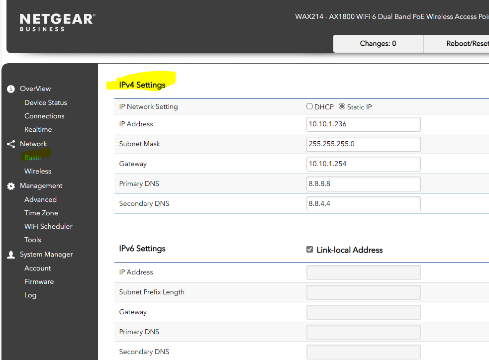

Here in my LAN, the WAX214 is connected to the usual network (either by DHCP, or here for my test simplicity on a static IP):

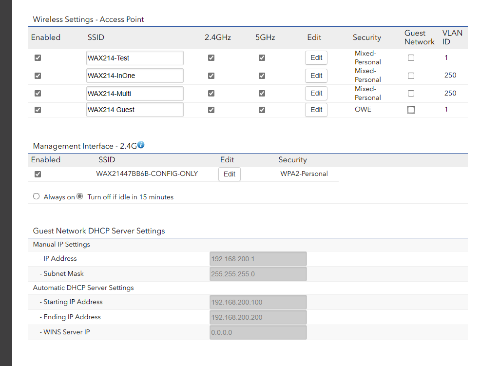

Now, how is the guest network configured - with a [x] to be a Guest Network, making up an isolated IP subnet, just for the wireless guests, NATed many to one on the WAX214 LAN IP? In this example, I have set security to OWE, to allow anyone accessing this SSID and the guest network. Note this 192.168.200.1/24 network is known on the WAX214 only::

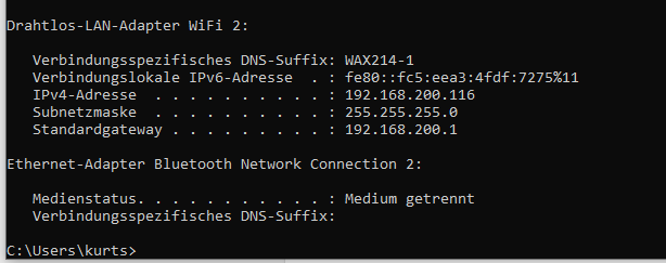

With this config, the wireless test client does get an IPv4 address assigned to this isolated 192.168.200.1/24 subnet, and it can reach the world (Internet) - just as I'm editing the post here currently:
Or do you have mapped the SSID without ticking the Guest Network, but mapped it to a VLAN, here the LAN basic VLAN 1?
Does this help?

Hi Schumaku
Thank you for your reply
I think I must change DNS address 192.168.1.1(router IP) to 8.8.8.8 and 8.8.4.4 on WAX214
I will do it and tell
Regards
