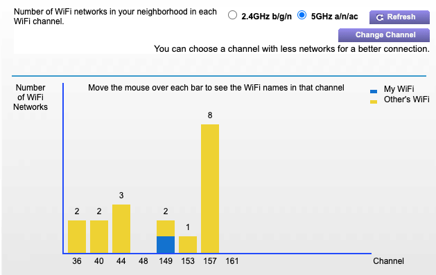

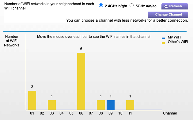

Last time, I took the channels off auto and I selected 9 for the 2.4G (because 1, 6, and 11 were heavily used) and 149 for the 5G. I've attached the images below. I live in a townhome so there are a number of competing neighbors, at least 11 - 18.
Currently, it seems the latest fix is holding without any disconnections -- which was yesterday I reset to factory and kept the default network names ("Netgearxx") as well as found a less congested channel.
I recommend you change to channel 11 since theres only 1 and 48 or 161 since nobody is using that channel. I guess you can use channel 9 however it's not recommended has its not a primary channel. See how it works for you though.

Images seem to not be loading. I've attached a link to the photos here to the wireless channels: https://imgur.com/a/Tw35rpz
