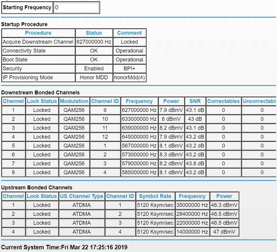

I just switched accounts with my service provider today to keep the introductory rates. I have the same plan as before (200 Mbps). With everything same, while I was getting ~200Mbps download and ~34Mbps download, now I get only 28 / 5. Since its my own hardware, service provider is refusing to do anything saying its my problem, unless ofcourse I pay their tech to come over.
I guess that is my final option. Wanted to check if anyone else has any thoughts on it.

    everything showing looks great.  Were you getting the full 200mbps speeds before switching accounts?
    Are you sure they switched accounts?  You don't say which provider you're going through but usually a modem has to be removed from an old account to become associate with a new account. Might be something to check on to see if they actually switched the modem to a new account and didn't just leave it running on the old account. Especially if everything worked fine prior to them switching it.

      Thanks for your response.
      I am using Optimum (only option I have). I dont know how to update modem association with account, I am guessing that's something the technician would have done?
        i've never used optimum. it would take a technician to change the association but if the only thing changed was accounts, i'm inclined to think thats were the problems coming from.
