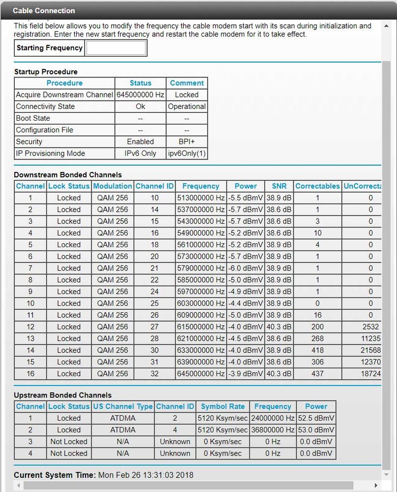

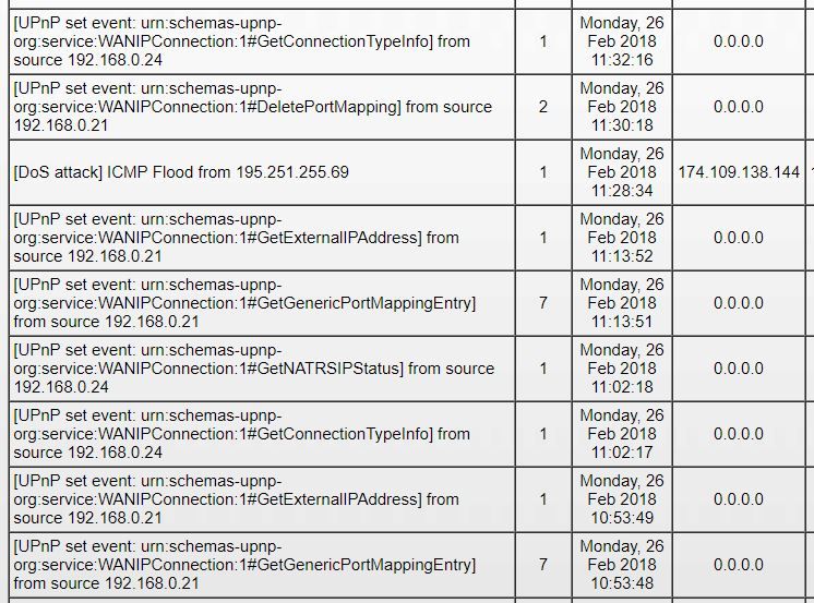

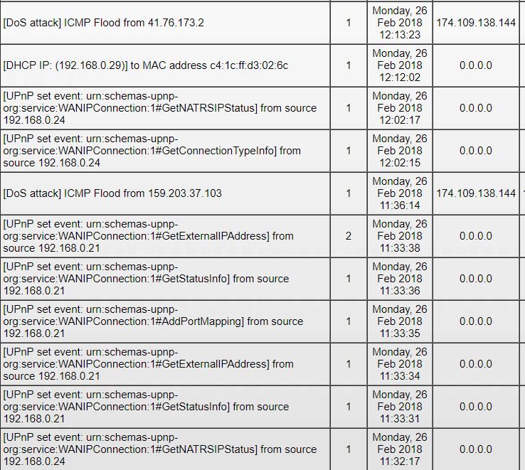

C6300 Dropouts / DoS Attacks
Recently having a ton a dropouts so I decided to peek at the logs, I have no idea what I'm looking at, but I came across several DoS attacks that seem to line up with the time of the dropouts.  Would supremely appreciate help from someone who can decipher this foreign language.  What should I do?  Does anything else look awry?

    Hello Schmohawk
    On channels 12-16 you have a ton of uncorrectables could be some type of cable line issue in your home or outside to your connection box I suggest having your ISP send out a tech to check things out.
    DarrenM
