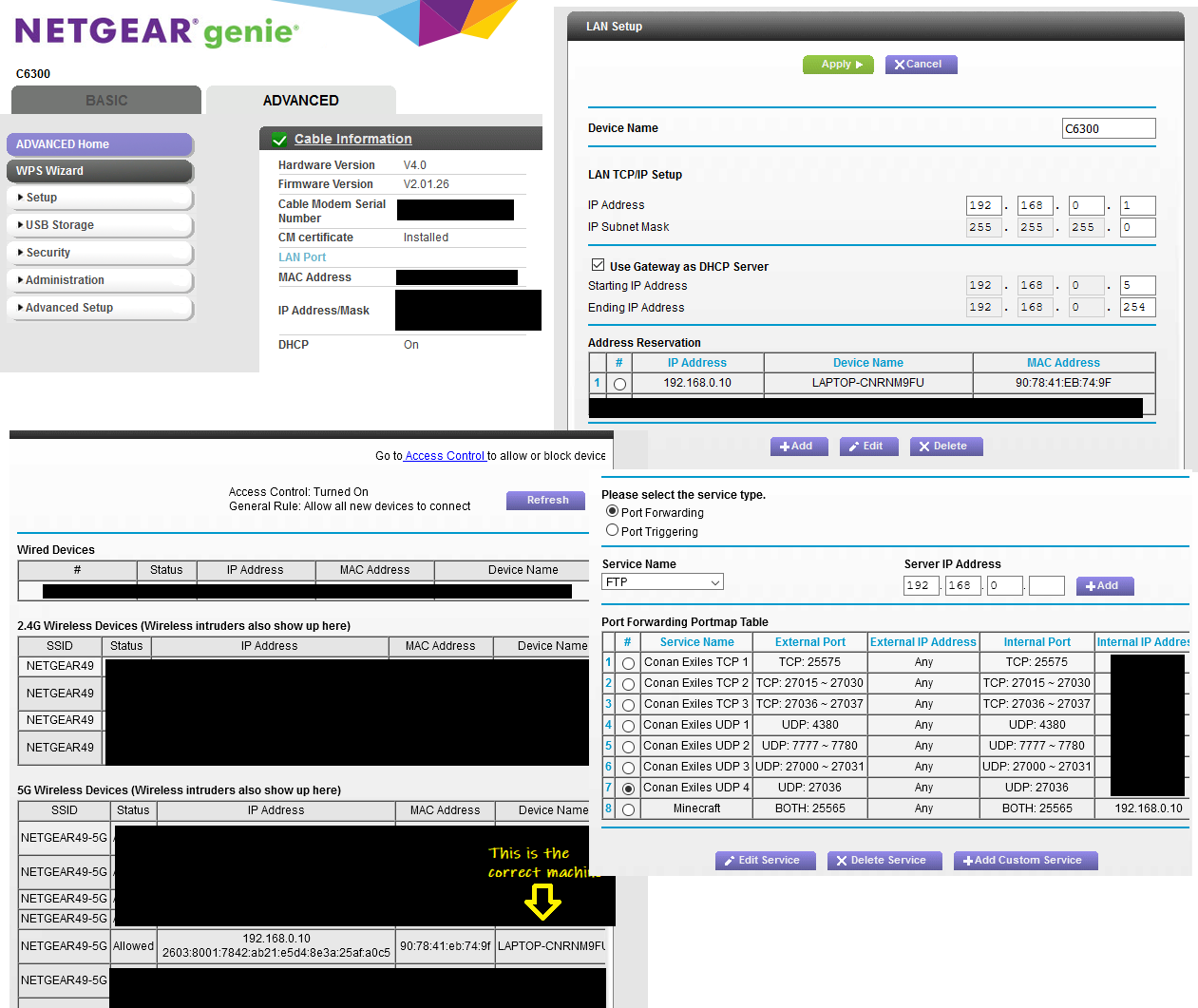

I am struggling to make port forwarding happen. Please find attached a png that is a set of screenshots of what I have set up. What did I get wrong?
  • I have a static IP configured for the server (it's Minecraft).
  • I have the server running and all on the LAN can connect.
  • I have the ports set up for forwarding.
  • The Conan Exiles stuff behaves the same - all can connect from LAN, none from outside.
  • The external test sites I tried say the port is closed.
Note: I'm not 100% on the Model number, I only see C6300 anywhere. It's got wifi. It's got the NETGEAR genie SW as shown in the attachment screenshots.
What else might be going on? Thanks in advance!

    • igHunterKiller's avatar
      igHunterKiller
      Log.png (attached to my last post) shows that the router recognizes activity from a test website (I've tried several, thought I've reset the logs in between) and recognizes where I'd like them forwarded, it's just the test websites do not report the port open. I said seems, because it seems to me that all the configuration is correct, and the router reports what I want it to do. Is there something in the pictures I attached that is incorrect? If there's another section of the settings to include, please let me know.
      I've attached the results of the test you recommended.
      I have no other router or repeater - this is a straightforward setup. I've tried both wired and wireless connections for the server. In both cases LAN addresses can connect successfully and WAN addresses do not.
      >> If your ISP is causing the problem...
      Is there a way for me to confirm/prove that?  I called them and _of course_ they say everything ought be working, so I'm not sure what action to take along these lines. My next step is to try a different brand of router.
      Anyway, I assume since the settings as pictured were not addressed that they are reasonably configured. If there are additional pictures/sections of the UI I can provide that would help clarify, let me know. There aren't any "commands" to talk about. I configured the router for port forwarding and the games I am attempting to enable see LAN clients connect successfully, and WAN clients cannot. The log again seems to indicate that it is ready to forward, but it's just... not doing it. Maybe I'm reading that log wrong.
           Your WAN/Internet IP address is a valid public address, which covers
        usual problem 1.
           Your port-forwarding rule 8 and address reservation seem plausible,
        which covers usual problem 2.
           That connection log seems to show the desired port forwarding.
        > You seem to have 2 and half of 3 covered.
           Still true.
