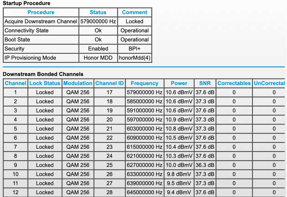

Any help would be greatly appreciated. Posting logs as well:

    Photos can take several days to show up as a moderator has to approve them. And we don't usually check back unless there's a new post.
    click on "choose file" and add them 1 by one.
    Include screen snips of the cable connections page and the event logs.
