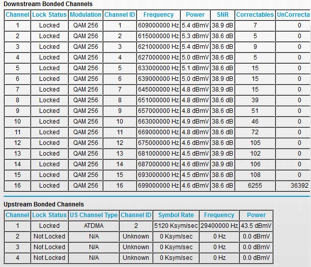

C6300 upstream Issue
Currently my upstream light is Amber color.  It was not like that untill less than a week or two ago.
Tryed talking to comcast/xfinity  and they say it is not there issue.  I can surf the net just fine however not sure if this upstream issue is also affecting me when i play on my desktop.
There are other devices that are on my wireless but they are not active enough to cause an issue. ( cellular, console, and fire stick )

    Only 1 upstream channel is locked you may have to ask for higher tech support at comcast that will be able to help you lock onto more upstream channels.

      I'll try but they thus far have been giving me the run around
      • mikp16's avatar
        mikp16
        and once again comshaft claims thats its the modem
