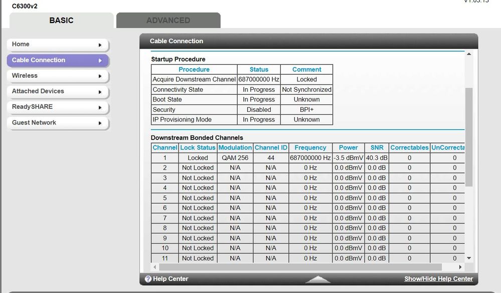

- plemansGuru - Experienced User
got a copy of the cable connections page?
That helps check the connection back to xfninity
And if they were messing with the lines and this all started afterwards, tends to point at the ISP.
