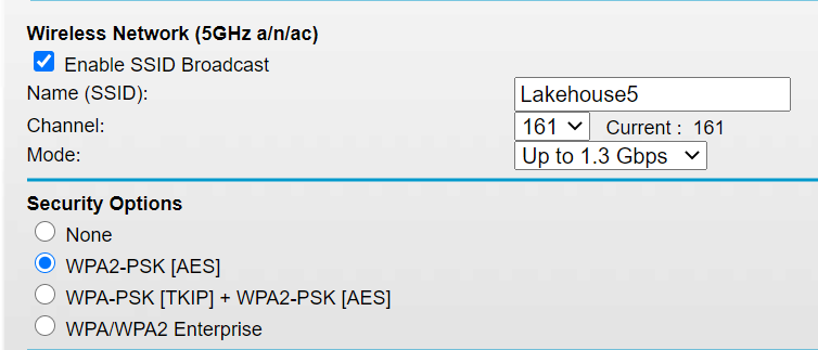

I can't get even 100 mbps hardwired or on the 5gHz wifi through the Netgear even though the settings are for "up to 1.3Gbps".
WHAT do I need to change?

    1. There is definitely a different from 2.4ghz to 5ghz. 2.4ghz is much much slower and more suseptible to interference
    2. What speeds do you get hardwired into the c7000? Its a bit pointless to try to get wireless faster than what its getting wired
    3. What device you're testing on is important. A 1x1 antenna devices isn't going to have the same speeds as a 2x2.
