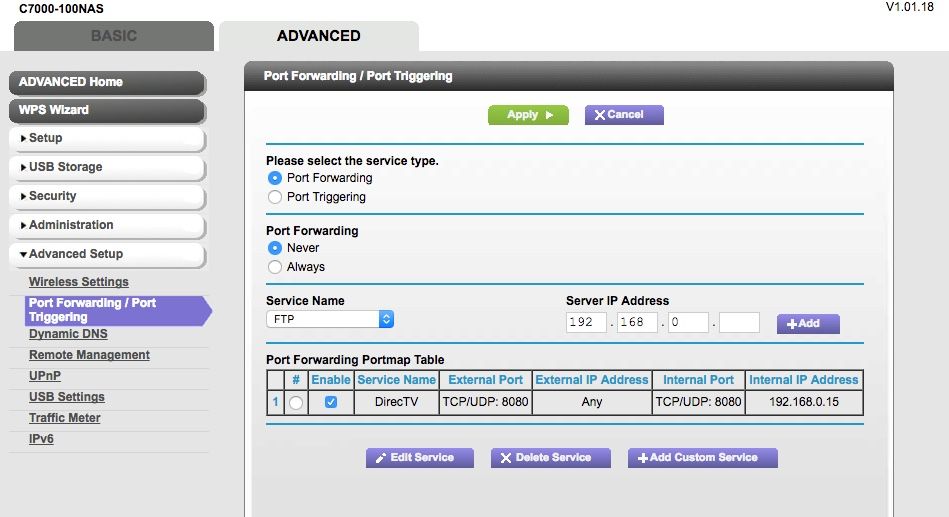

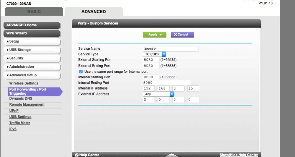

C7000 Port 8080
Hi everyone! i am trying to control my DirecTV over port 8080. I have created a static IP for my DirecTV and enabled TCP/UDP port forwarding of 8080 to the DirecTV static address. When I tried to...
As usual, showing actual actions with their actual results (error
messages, reports, ...) can be more helpful than vague descriptions or
interpretations. Copy+paste the actual port-forwarding rule and address
reservation?

- erinnire5Sep 28, 2017Aspirant
Yeah, I was just told never to share ip addresses. But the command does work within the LAN, just not the WAN. And I have Port Forwarding open.
> reservation?
Still waiting.
Perhaps. I want to see the evidence.

Oh gotcha. Sorry I misunderstood before. So the DirecTV IP Address is 192.168.0.15. This is what I changed in the router.
