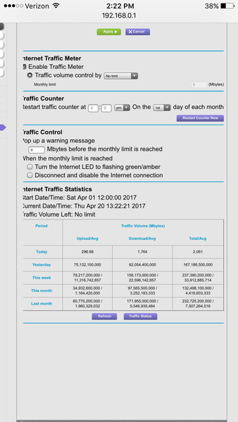

C7000 Very High Internet Traffic stats ( Spectrum )
I have been noticing very high traffic on my C7000 nighthawk router. I have Time Warner / Spectrum as an ISP. Does this type of traffic appear to be common ? I only have 2 devices connected throu...

I am seeing the same thing with the C7000 and Spectrum. I mean look at these crazy high numbers for the month. I only stream Netflix at night a couple episodes. Never download huges files. I looked in my router logs, and see nothing wrong. No devices attached, except for my home devices. No rogue devices. I logged into Spectrum, and for the past 14 days, their side says I used 74GB for this month so far. But the Netgear modem shows much more higher usage. lol.
