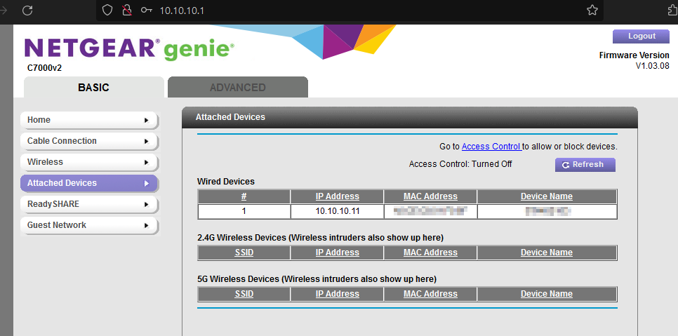

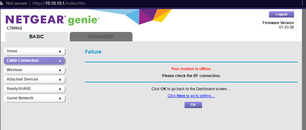

Thank you for the reply.
Connection status: (there is no coax plugged in, intentionally):
Lan connection
Event log

Would need to see the requested data with the ISP service coax cable connected.
