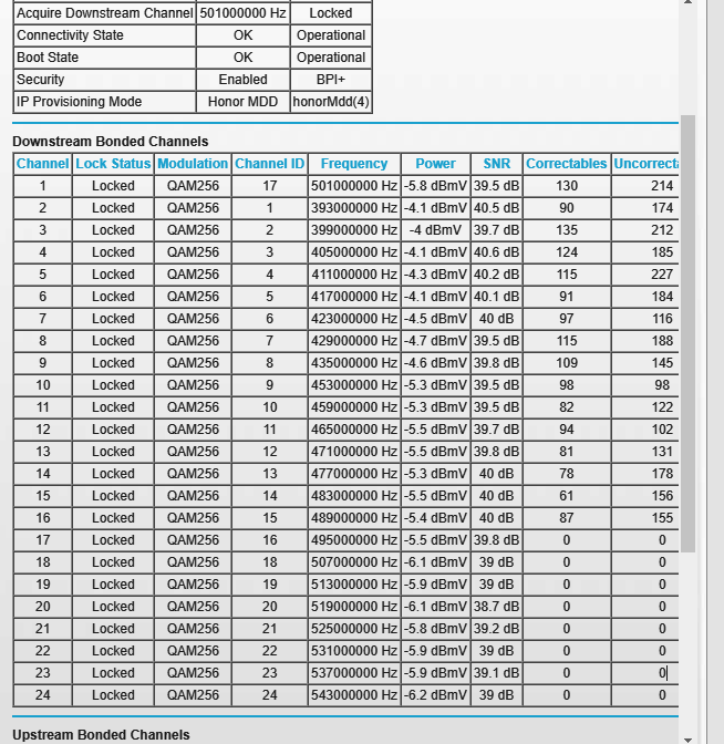

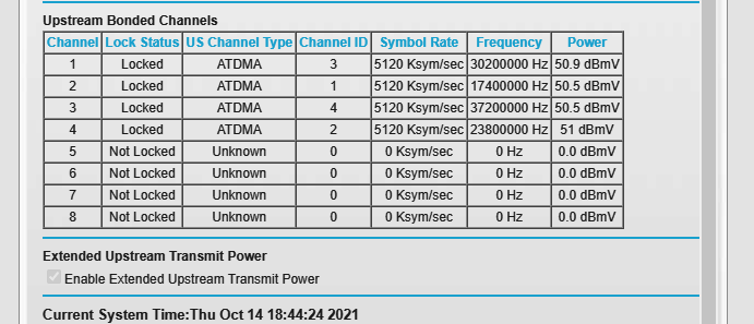

https://ibb.co/CJvK3nW
https://ibb.co/X7gCRz6
https://ibb.co/vHXVd6v
https://ibb.co/7KW9N5Dsorry first post didnt like my pictures.
Seeing some correctables and un-correctables being reported and lots of cirtical events. Something the ISP needs to take a look into.
