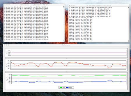

- samjonesOct 29, 2016Aspirant
Yeah no problem, heres a screenshot of the traceroute and a few other pings, the only ping that worked was the one to the router. It's weird because I can see that the router's connection to the internet is still working perfectly and all other devices aren't having any problem. After turning off the wifi and turning it on again it starts working, but then after a random amount of time it will stop working again.
EDIT: I should also note that this happens on every network I connect to, at home, work, friends house, everywhere.
