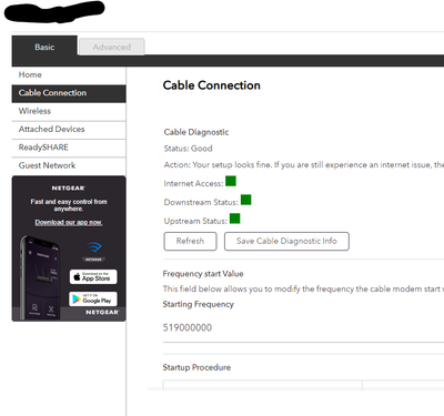

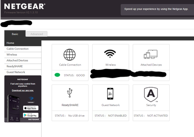

      got a screensnip of the cable connections page and event logs?
      That helps check the connection

        Router Settings Home Page:
        Cable Connection Page:
        If its the same issue, Internet Access would be Red, but have a note next to it that says something about the "Traffic Meter" limit was hit and to increase the limit.
