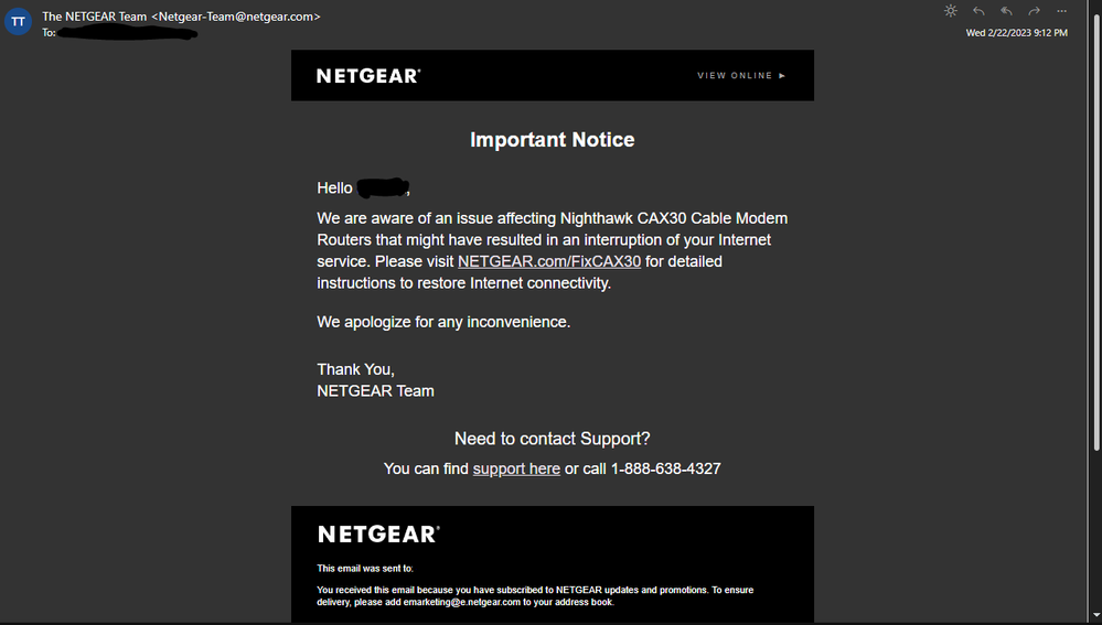

When I viewed the latest firmware versions; I was unable to download it. So I downloaded to a previous version (1.4.11.2) . But it seems like Netgear changed it so the "latest" firmware is now 1.4.11.2. I forgot what firmware I was on; but I did revert to a previous version. I also got the email about the cable modem. So it seems like there was another "latest" firmware version had issues of it's own and removed.
edit: the "latest" firmware version I was on was 2.1.5.2. That version is not available to get at this time of this post.

It's been a few days and so far downgrading the firmware has fixed the issue. I didn't need to unplug the modem to restart it since then.
