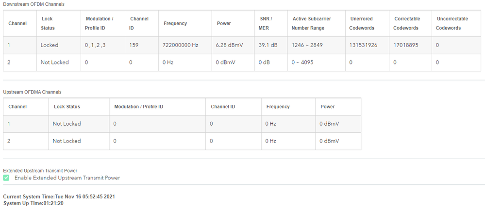

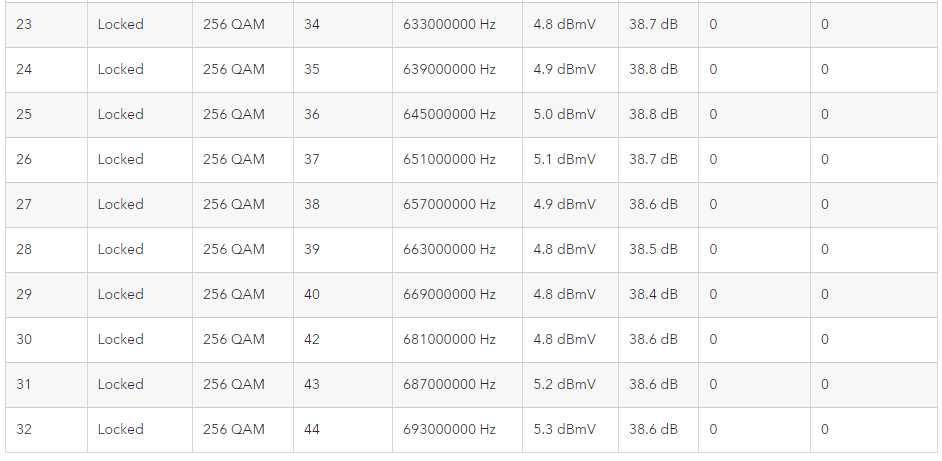

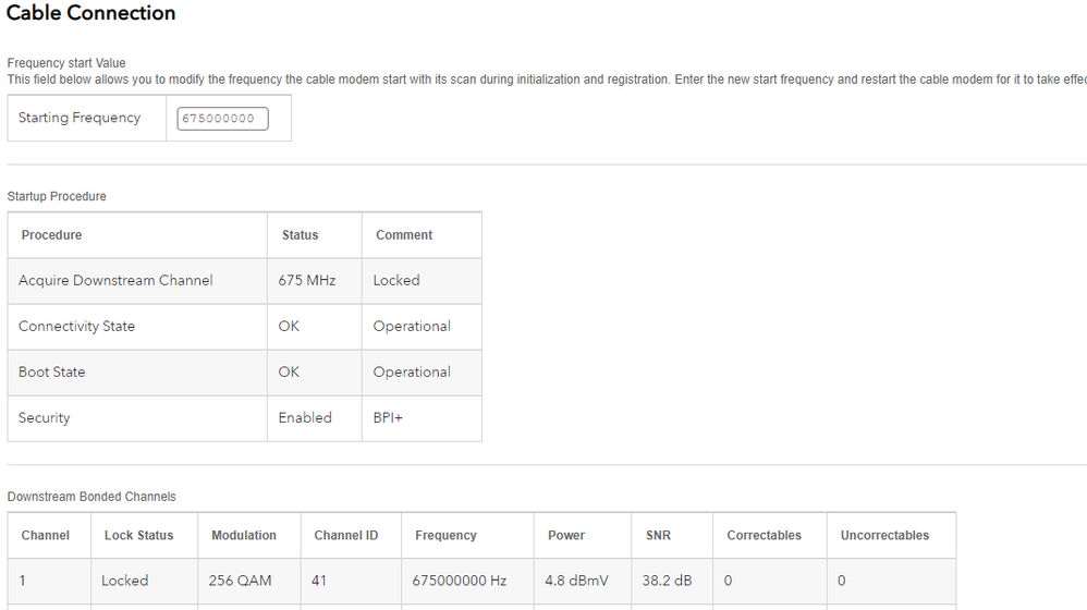

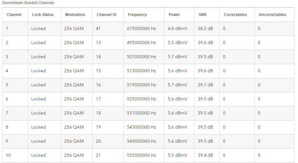

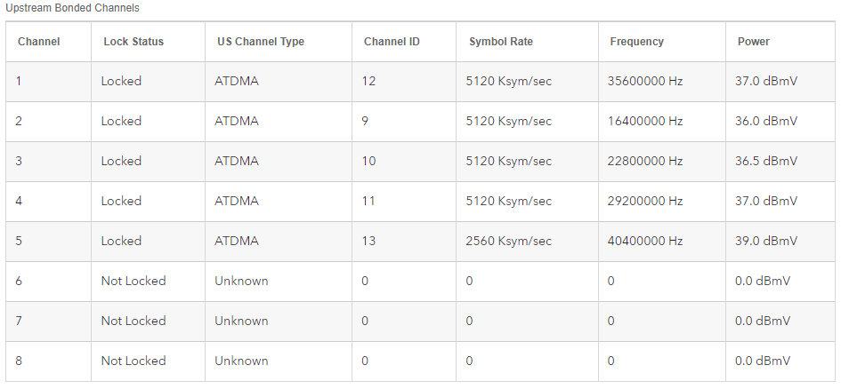

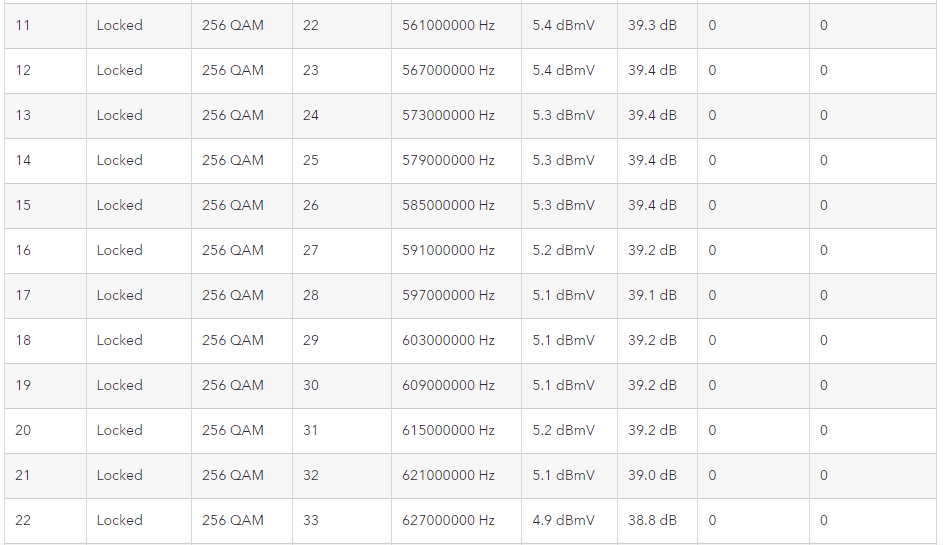

Cable Connection screenshots during normal utility power.
