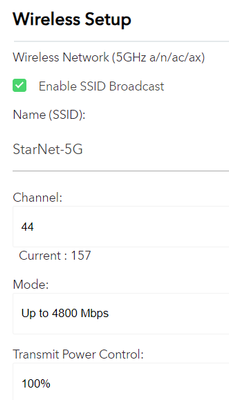

      Wireless Settings (5GHz)
      Name (SSID)StarNet-5G
      RegionNorth America
      Channel149 + 153 + 157 (P) + 161
      ModeUp to 2400 Mbps

      • FURRYe38's avatar
        Try channel 40 and 149
