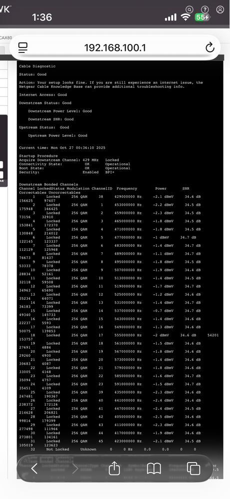

If you can still access the CAX web page, Please post a copy and paste of the modems connection status and event log page.

- KingsshadowOct 27, 2025Aspirant
I’m not currently home but I figured you might ask for that, this is what I took last night before I went to bed

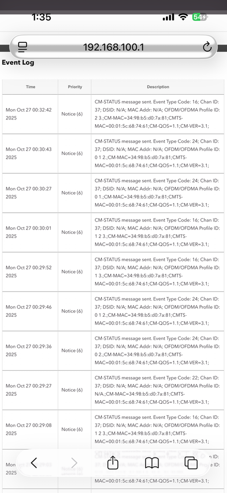

- FURRYe38Oct 27, 2025Guru - Experienced User
You have tons of correctables and un-correctables on the line. Those should be mostly zeros there.
Power levels are with in specs.
Have the ISP check the signal and line quality UP to the modem. Be sure the ISP provisions the modem correctly. You should get a tech on site.
Be sure there are no coax cable line splitters in the between the modem and ISP service box.
Be sure your using good quality RG6 coax cable up to the modem.
Start with removing any amplifiers, signal attenuators, or splitters from the coax.
From there check the line for kinks, damage, moisture in the line.
Check the connectors for improperly made ends, foil touching the copper coax line, loose connections, bad/old/cheap connectors, or corroded connections. Replace them if you do.
Be sure to power OFF the modem for 1 minute then back ON.
https://community.netgear.com/t5/Cable-Modems-Routers/General-info-and-Troubleshooting-for-Cable-Modems/m-p/1530376#M12853\https://kb.netgear.com/24311/Power-level-guidelines-for-a-NETGEAR-cable-modem-router
https://www.duckware.com/tech/solving-intermittent-cable-modem-issues.html
https://highspeed.tips/docsis-events/
Any Criticals, Errors or Warnings seen in the event logs needs to be reviewed and resolved by the ISP. Indicates a signal issue on the ISP line up to the modem.

For the collectables and uncollectables are the lines you’re looking at the ones directly underneath those words where there’s numbers 1-32 and locked respectively?

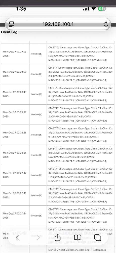

As for the event log I already had attached a picture to the original post but here’s both photos from last night:
