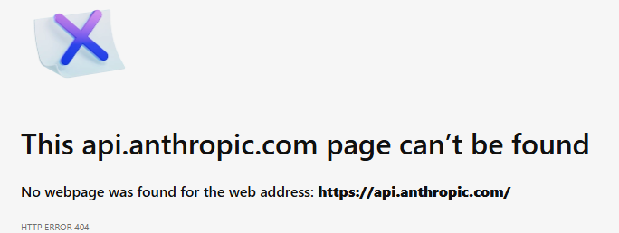

    Confused.  On Spectrum in the US, I entered https://api.anthropic.com into the Edge browser and got this:
    Same results with other browsers. (Brave, Chrome, Opera, etc.)  My guess is that this URL is not supposed to lead to a web page, but rather to a programming interface? (api?)

      CrimpOn wrote:
      Confused.
      Read this:
      This is not a web page, it is a RESTful API that allows developers to access cloud-based Claude models from their applications.
