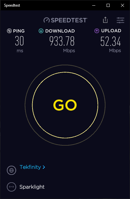

- FURRYe38Dec 04, 2021Guru - Experienced User
I Put my CAX80 online as router today. I'm seeing good download speed on the wire.
I'll check this over the weekend.
