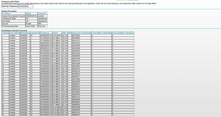

I'm curious if anyone has had a similar situation as I have with their NetGear CM1000. I've been waiting for a few days for a reply from support and figured I would post here in the meantime.
I...

signal levels look ok (except the fact that DS signal is bit high). Comcast recommends it below 7dB.
have you checked the comcast modems for prolonged use as well?
Please pull this power table and also most importantly even logs when you see low throughput and post them here. do you see uncorrectables when the issue happens?

The tech had his plugged in and running for about an hour with no issues. He said I could go rent one to use for testing and return it within 30 days and not be charged. Not sure I trust Comcast enough to try that.
