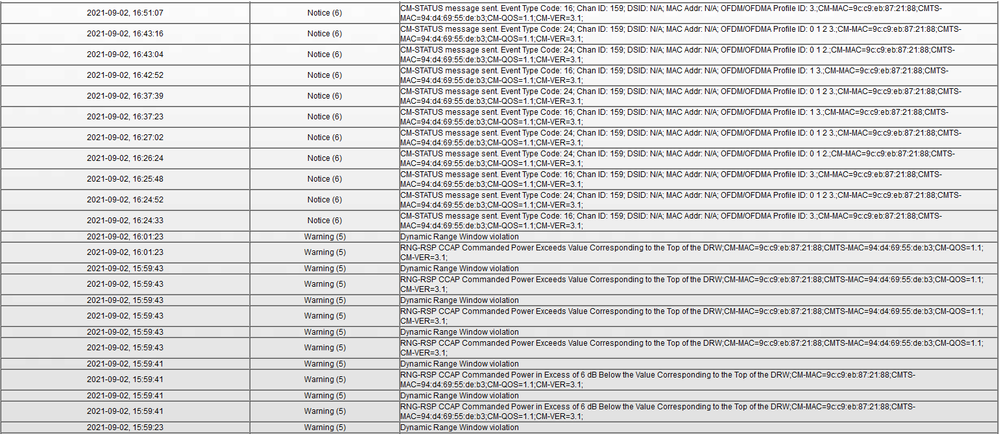

So for the past few months my family and I have been having some issues with the internet dropping for about a minute. During these times the ammout of packets that drop is around 75%. Looking into the modem I see quite a few errors stating "RNG-RSP CCAP Commanded Power Exceeds Value Corresponding to the Top of the DRW" and "CM-STATUS message sent. Event Type Code: 16, CM-STATUS message sent. Event Type Code: 24".

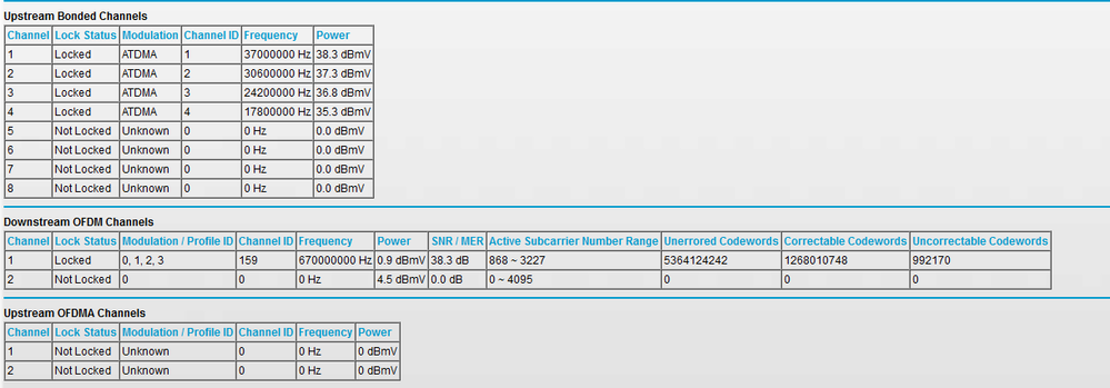

  • This is the pic of the upstream since for some reason the pictures I uploaded to the OP wont load.

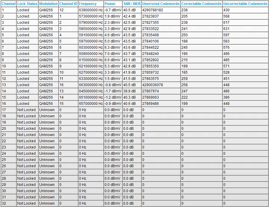

  • plemans's avatar
    plemans
    you have a bunch of channels that aren't locking and your power levels are out of spec. They should be within 3.5dbmv of each other. And you're going from -1.7 to 7dbmv. Way out of spec.
    Remove any splitters, amplifiers, or signal attenautors in your coax line.
    Check the line for kinks, damage, old/bad/loose/corroded connections and replace them if you have them.
    preferably, move the modem to right where the coax enters the home to prevent wiring in the walls/floors from being the issue.

      But on the channel side of things, is it normal to only have 16 of them locked? ive never had more than that.
      • FURRYe38's avatar
        Who is your ISP?
        Usually for higher speeds, like 1Gb, all 32 channels are usually locked in  for the download.
        Ask the ISP  what  they  use for channels and how many they have locked in for there cablem modems?
