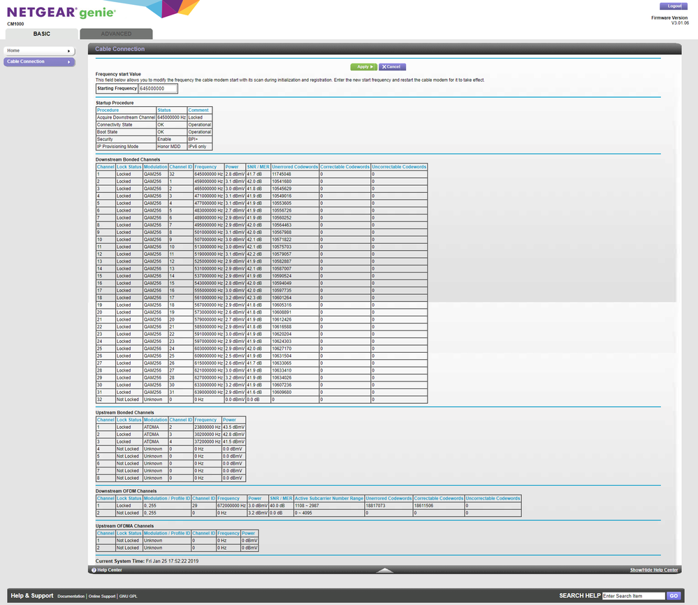

CM1000 Slow Downloads on Xfinity Gig Service
Could you provide feedback on my modem's  (Netgear CM1000) signal levels?  I have Gigabit Internet service, but am only getting consistently around 550Mbps; however, my uploads are dramatically improved since the upgrade.  Thanks for your time and efforts!

      https://pickmymodem.com/signal-levels-docsis-3-03-1-cable-modem/
      This web page had some good info on what the signal levels should be for an optimal connection.
      Looking at what you posted there, you're in good shape? The absolute lack of ANY recoverable or nonrecoverable errrors on any of the channels is almost hard to believe.  (Did you capture that log immediately after rebooting the modem, perhaps?)
      I was told my own cable connection with Comcast was "excellent", and I have between 850 and 1600 or so recoverable and non-recoverable errors logged for each of the channels.  (That's supposed to be "within spec".)  So having 0 is amazing, IMO.
      • pabearsman's avatar
        pabearsman
        Thanks for your response. Those results were captured shortly after a modern restart. I'll check the log again tonight when I get a chance. Bottom line is there still isn't any improvement.
