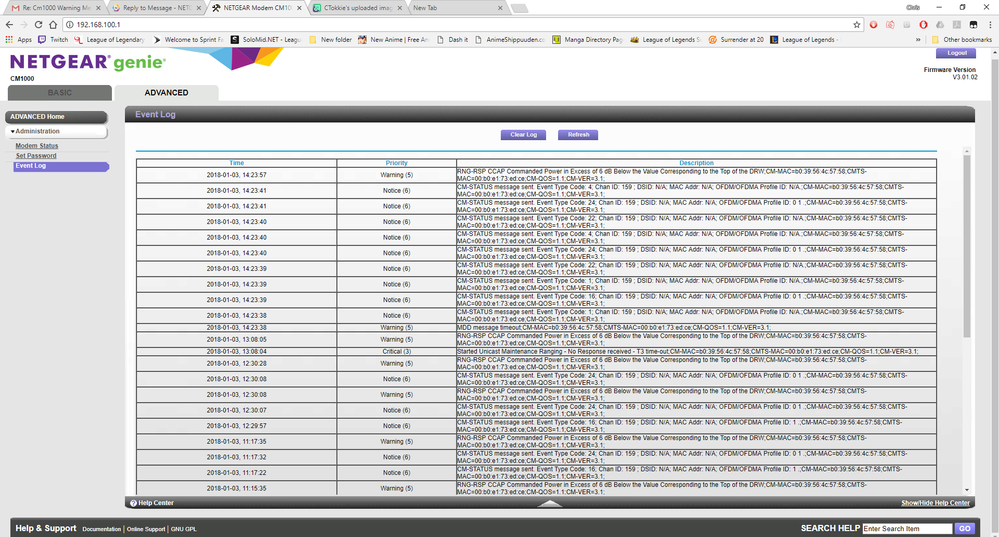

Cm1000 Warning Message
So I logged into my Modem and i see this in the logs. RNG-RSP CCAP Commanded Power in Excess of 6 dB Below the Value Corresponding to the Top of the DRW;CM-MAC=b0:39:56:4c:57:58;CMTS-MAC=00:b0:e1...

- CTokkieJan 03, 2018Aspirant
My ISP is actually Cox Cable
From the screenshot i posted looks like i'm on 3.01.02
Here's another screen shot of my logs, I don't see anywhere to perform a firm ware update
- vkdeltaJan 03, 2018NETGEAR Employee Retired
Cox will need to Push the FW.
We have already provided new FW to Cox and they have not yet certified/push to their customers. There are several DOCSIS fixes in the new FW and I hope Cox will push to their customers very soon.
Can you please call Cox and plead them to push new FW?
Additionally, it would help you send me your CM MAC and account # (PM me in the info and dont post it publicly here) and I will check with Cox contacts if they can do a temp push to just your modem?
