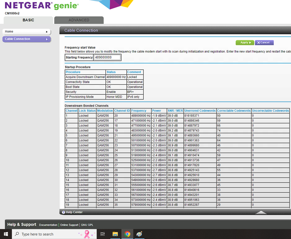

I've been battling disconnects, from 2-10 a day, packet loss, slow speeds. Playing World of Warcraft or Call of Duty becomes unplayable due to normal 50-60ms speeds going to 1100-2000ms+.
I've spent so many hours both online and telephone chat with Xfinity tech support. The last time a tech came out he replaced 85' of line from the pole to my home. It was ok for a couple days then right back to the same issues.
I've been keeping logs over the last few days. My time is off by 6 hours on the modem.

Please post a copy and paste of the modems connection status page.
https://kb.netgear.com/30007/How-do-I-obtain-the-cable-connection-information-from-a-NETGEAR-cable-modem-modem-routerBe sure your using a good quality LAN cable between the modem and router. CAT6 is recommended.

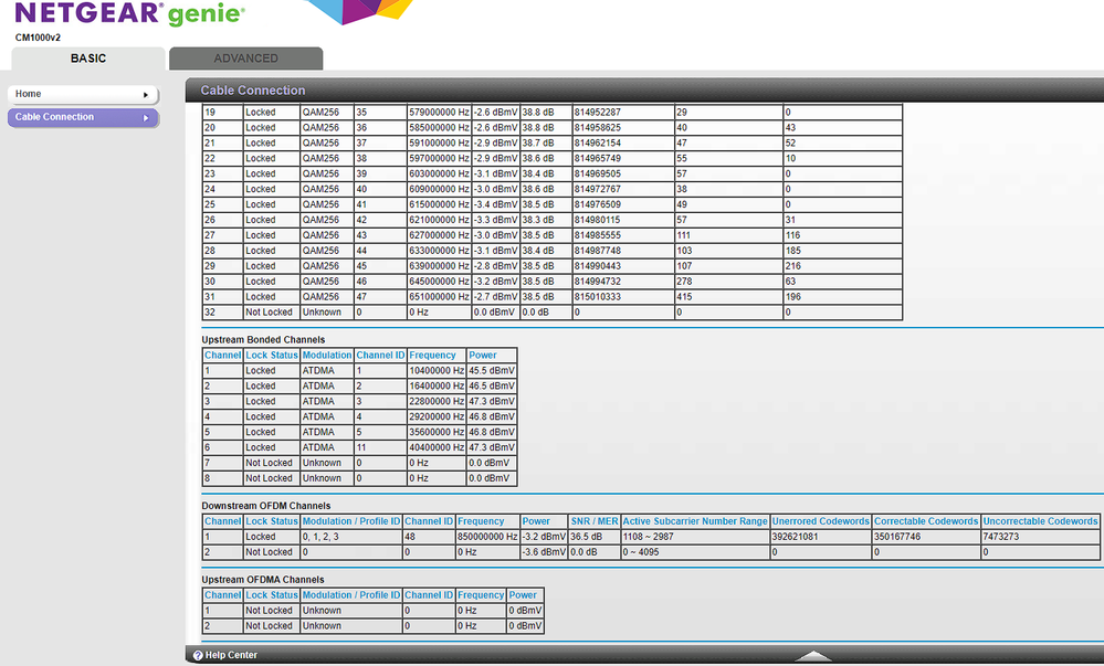

Your main channels have some correct and un-correcables.
I see the OFDMA channel has tons. This should be near zeros. something the ISP should help you resolve. Something to check the coax cable line and remove any splitters. Check all jack fittings and such.
Have the ISP check the signal up to the modem as well. Power on the line is a bit on the low side but in spec.CAT6 UTP is fine.
