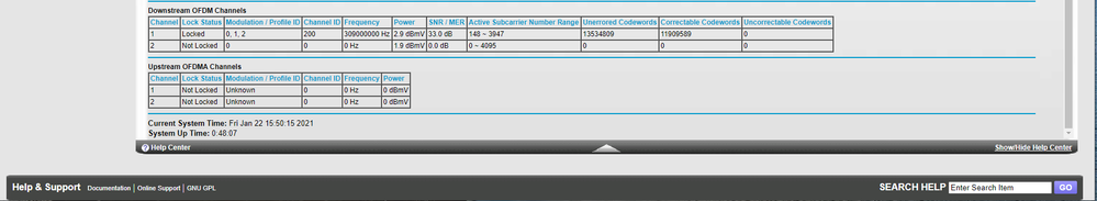

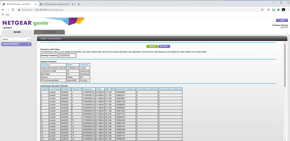

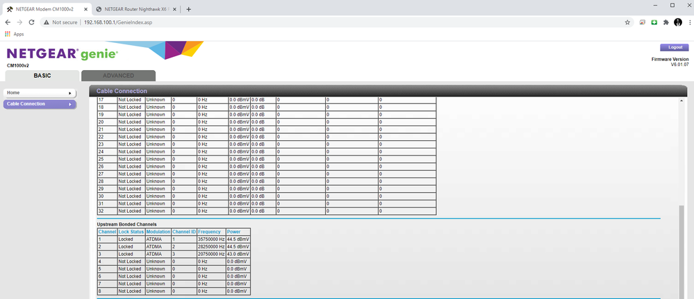

The following pics show where I believe the problem is but the service provider says "everything checks out", "its normal to see that", "thats not the problem".
What causes the modem to only see/show 16 channels for downstream and only 3 for upstream? Is that a service provider problem or is it something to do with this modem?

Have the ISP check the signal and line quality UP to the modem. Be sure the ISP provisions the modem correctly.
Besure all 31 or 32 channels are lock in for a 1Gb service.
Be sure there are no coax cable line splitters in the between the modem and ISP service box.
Be sure your using good quality RG6 coax cable up to the modem.
