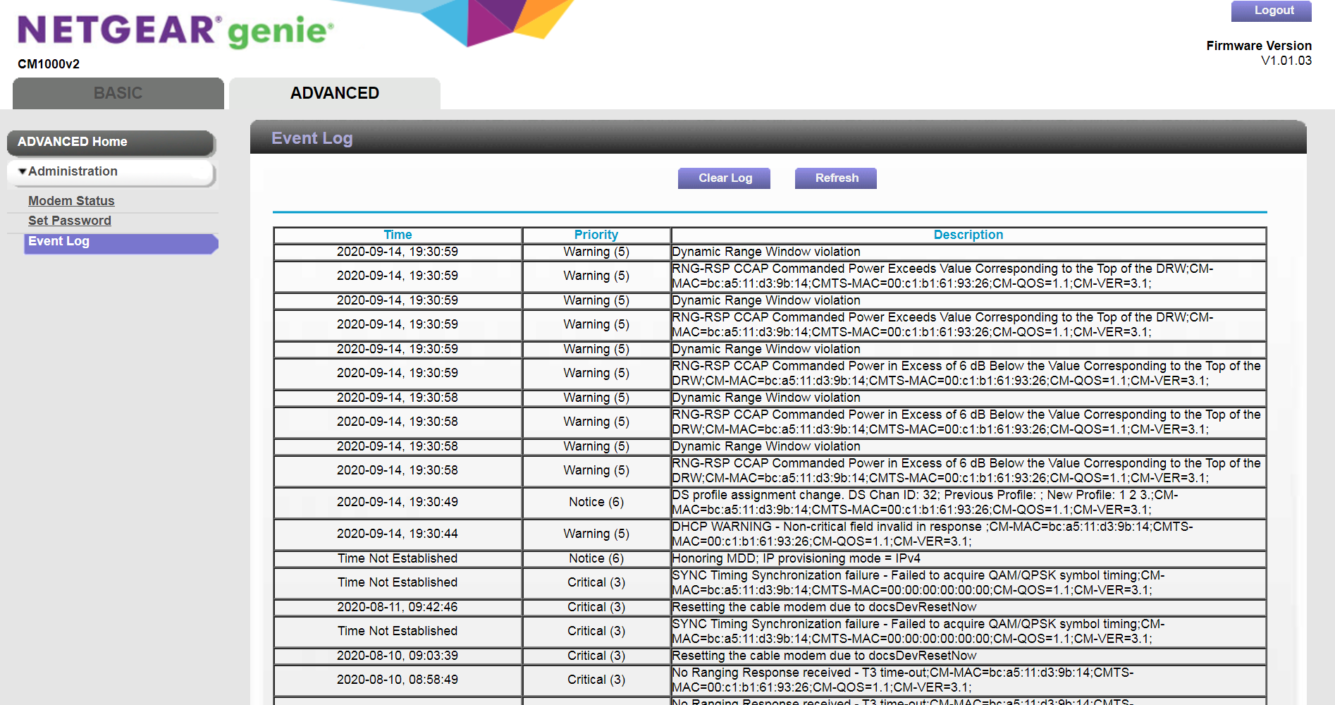

I have the CM1000v2 (Firmware version V1.01.03) and have been using it with no issues since the end of July with my ISP (Optimum). Just today, the internet connection dropped all of the sudden. I rebooted it and connected my computer to it directly, removing my router, and my internet connection was still gone.
In the event log, I see the following:
2020-09-14, 19:30:59 Warning (5) Dynamic Range Window violation
2020-09-14, 19:30:59 Warning (5) RNG-RSP CCAP Commanded Power Exceeds Value Corresponding to the Top of the DRW;CM-MAC=bc:a5:11:d3:9b:14;CMTS-MAC=00:c1:b1:61:93:26;CM-QOS=1.1;CM-VER=3.1;
2020-09-14, 19:30:59 Warning (5) RNG-RSP CCAP Commanded Power in Excess of 6 dB Below the Value Corresponding to the Top of the DRW;CM-MAC=bc:a5:11:d3:9b:14;CMTS-MAC=00:c1:b1:61:93:26;CM-QOS=1.1;CM-VER=3.1;
2020-09-14, 19:30:58 Warning (5) Dynamic Range Window violation
2020-09-14, 19:30:58 Warning (5) RNG-RSP CCAP Commanded Power in Excess of 6 dB Below the Value Corresponding to the Top of the DRW;CM-MAC=bc:a5:11:d3:9b:14;CMTS-MAC=00:c1:b1:61:93:26;CM-QOS=1.1;CM-VER=3.1;
2020-09-14, 19:30:49 Notice (6) DS profile assignment change. DS Chan ID: 32; Previous Profile: ; New Profile: 1 2 3.;CM-MAC=bc:a5:11:d3:9b:14;CMTS-MAC=00:c1:b1:61:93:26;CM-QOS=1.1;CM-VER=3.1;
2020-09-14, 19:30:44 Warning (5) DHCP WARNING - Non-critical field invalid in response ;CM-MAC=bc:a5:11:d3:9b:14;CMTS-MAC=00:c1:b1:61:93:26;CM-QOS=1.1;CM-VER=3.1;
I've rebooted it and factory reset it and every time it turns back on, I get errors similar to what is above. Unlike some other forum posts here where the connection comes and goes, I have not gotten any working connection since the problem started about 4 hours ago.
I called my ISP and they claim that it's a problem with my modem. From what the logs say here, is that likely to be true? Or does my ISP just not know what they're talking about and the issue is actually on their end?
Thanks in advance!

      Thanks for your reply FURRYe38. I just had a tech out here, and he says that the signal coming in was fine. I actually ordered an RMA for the modem so I had two of the same modem at my apartment and both of them had the same issue. The instant they used their own modem/router combo (Ubee UBC1322) the internet started working again. I have no idea what's going on here. Which is more likely, I have two Netgear modems with the same issue? Or my ISP is purposefully blocking outside modems? Or something else entirely? I'm at my wits end.
