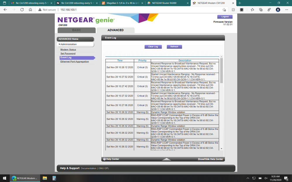

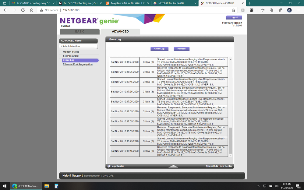

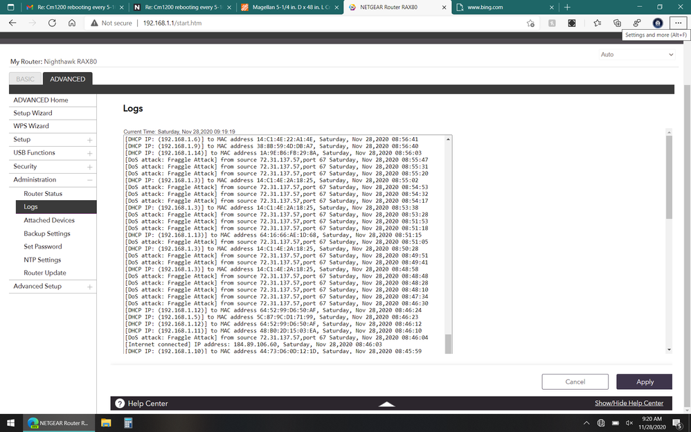

    do you have a screen snip of the cable connections page and the logs?
    Also, have you direct connected a pc to the cm1200 and ran it for a period of time? if it happens every 10 minutes, you should fairly quickly be able to tell if it truly is the modem loosing connection.
    • Scopoletus's avatar
      Scopoletus
      Tutor
      I have left both the Modem and router off last night and rebooted this morning. Same issue. I have now been on the Modem directly for about 20 min with no interuptions.
        Scopoletus
        Tutor
        Lost connection right as i posted the last post.
