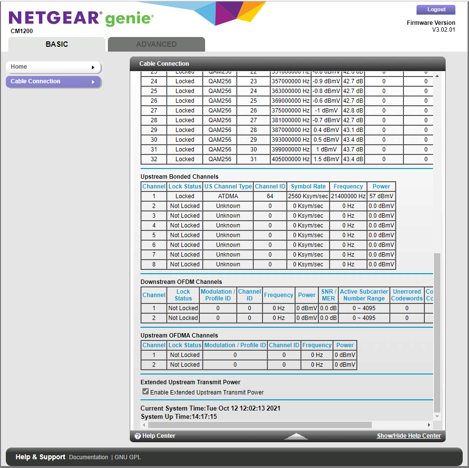

Hey everyone. Ive put in 192.168.100.1:8080 for the spectrum analyzer on the CM1200 modem and i get the following graph looking thing. looks like signal issues coming into the mdoem from the provider maybe?

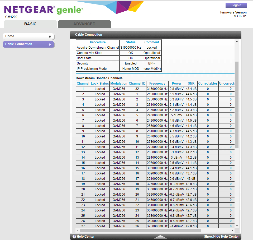

    Please post a copy and paste of the modems connection status page.

    1. why do you think you're having signal issues?
    2. got a screensnip of the cable connections page and the event logs?

        did you check your line/connections?
        You don't have "errors" in your line per the screen snip (event logs tell us more......) but your power should be within 3.5dbmv of each other and you're running from -1 to 5.5dbmv. so a 6.5dbmv difference.
