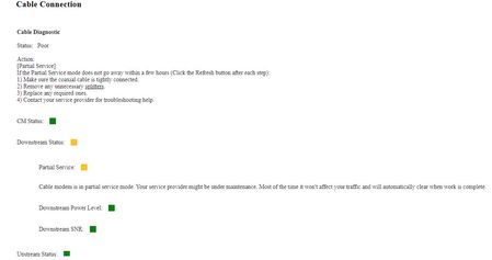

CM2000 Internet Dropping / Slow Connectivity / Intermittent Connectivity
'll keep this post updated if I do happen upon a resolution to this. I'm looking to determine if my download stream power is too high. I was reading that it should ideally be around 0db, but min...

Download power on some channels is on the boarder of too high in power. Also power levels seems a bit all over the place, chould be with in 3db across all channels. https://kb.netgear.com/24311/Power-level-guidelines-for-a-NETGEAR-cable-modem-router
