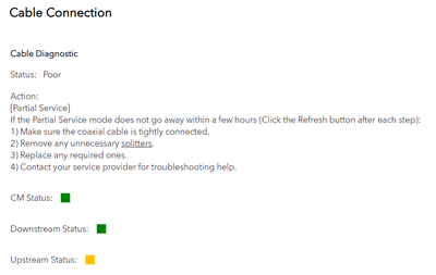

CM2500 poor status - upstream
My internet drops randomly numerous times per day.  I have talked with Spectrum a couple of times and had a tech out.  They say everything is good on their end.  I installed a new CM2500.  the upstream status says poor.  My levels all look good.  Any thoughts?
