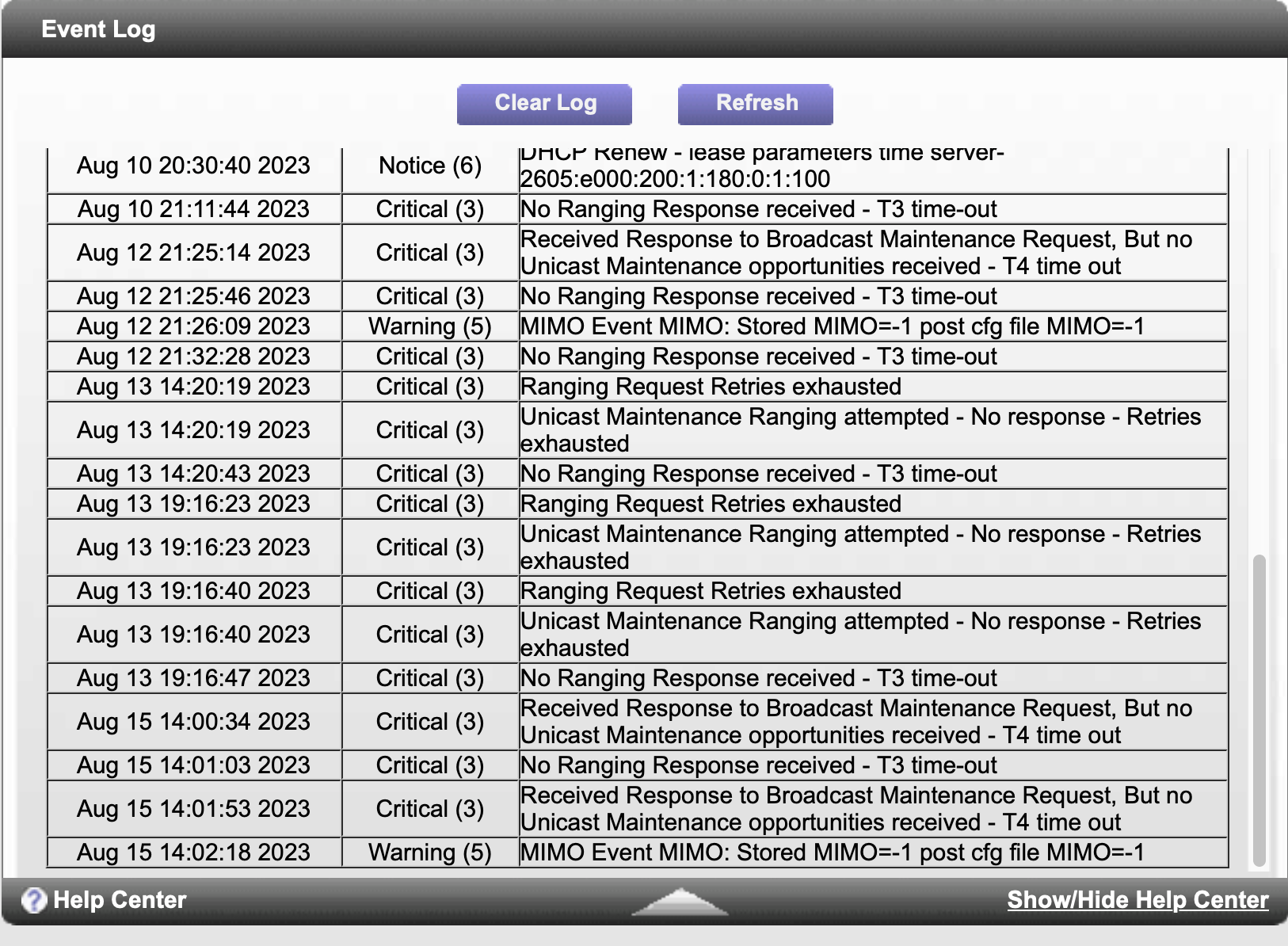

CM400 loses connection must be powered off/on have log file
CM400 loses connection frequently log file is incomprehensible to me. Can anyone here tell if I should blame my isp or my modem ? Log file attached. Thanx much. Dave.

Any Criticals, Errors or Warnings seen in the event logs needs to be reviewed and resolved by the ISP. Indicates a signal issue on the ISP line up to the modem.

From what I see already, power seems to be with in spec, however the modems Correctables and Un-correctables values should be zeros.

ISP says I need DOCSYS3.1 so am upgrading the modem. We'll see.
