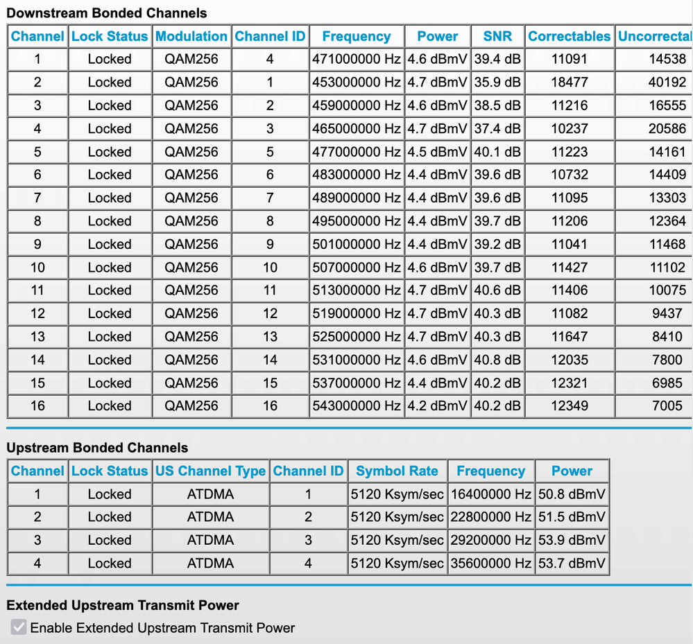

Finally, these are my modem's metrics:
Do these look normal?

You have a ton of correctables and uncorrectables.
Any Criticals, Errors or Warnings seen in the event logs needs to be reviewed and resolved by the ISP. Indicates a signal issue on the ISP line up to the modem.
Be sure your using a good quality LAN cable between the modem and router. CAT6 is recommended.
What is the brand and model of the host wifi router connected to the modem?Have the ISP check the signal and line quality UP to the modem. Be sure the ISP provisions the modem correctly.
Be sure there are no coax cable line splitters in the between the modem and ISP service box.
Be sure your using good quality RG6 coax cable up to the modem.
Start with removing any amplifiers, signal attenuators, or splitters from the coax.
From there check the line for kinks, damage, moisture in the line.
Check the connectors for improperly made ends, foil touching the copper coax line, loose connections, bad/old/cheap connectors, or corroded connections. Replace them if you do.
Be sure to power OFF the modem for 1 minute then back ON.

I checked out the links you sent. According to that, the correctables/uncorrectables are due to noise. So it seems like the issue has to do with my line or the ISP. Given that the ISP has been out here before and said their signal is fine, I'm suspecting something's bad in the line.

Ya, have tech come out on site and take a look. Have them look at the logs from the modem and info I posted about.
