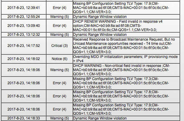

CM500 Intermittent Connection
I just installed a new CM500 cable modem and the connection has dropped intermittently averaging once an hour and the modem reboots. Here is the error log after the most recent one:

    you have too many Dynamic Range window violations.
    Please post your power values.
